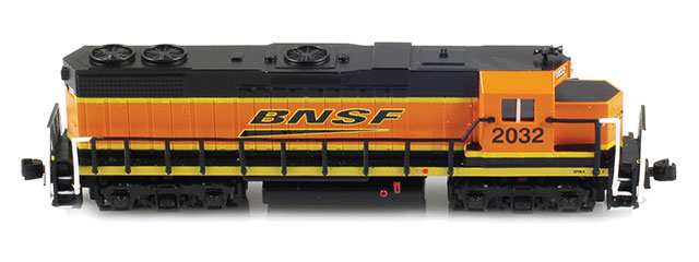

American Z Line added 4 new BNSF GP38-2's to their popular little Geep line. I already had 3 BN versions but had to add a new Burlington Northern Santa Fe engine to my roster. I opted for road number 2032 in the new "Swoosh" paint scheme.
File comment: AZL photo
I was very happy with it until I decided to add detailing and compared the loco with the real 2032. Oops, problem, BNSF 2032 is a GP35 rebuilt into a GP38-2 and doesn't really match in details. The other AZL engines #2007, 2013, and #2016 are rebuilt GP40's. All do not match the 38-2 body details.
The rear fan spacing should be further apart and the rear grill should also be longer. It looks like the 2032 now has a 38-2 dynamic brake blister and filter housing, but the cab doesn't have the rear overhang. I was going to scrachbuild it, but decided I could renumber it instead. In researching it, I found that BNSF has repainted 13 "as built" GP38-2's into the Swoosh scheme. They are for reference listed below:
