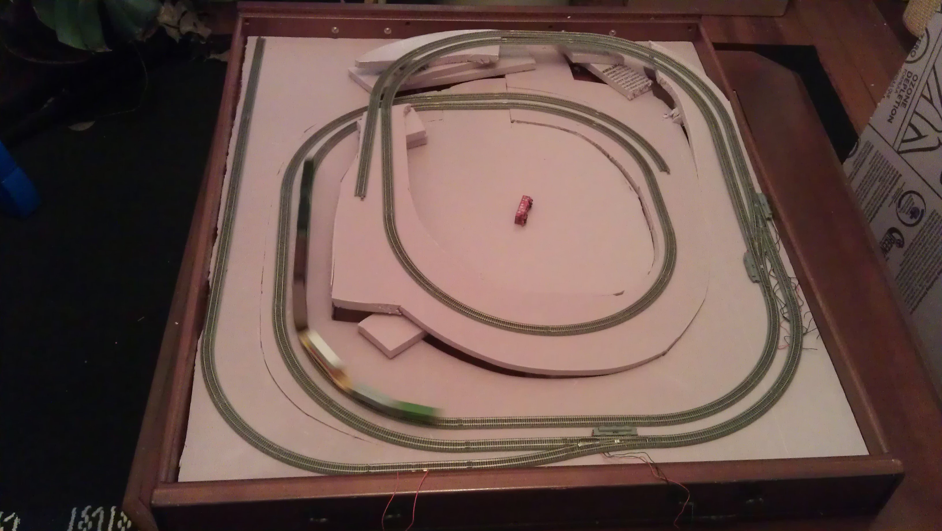

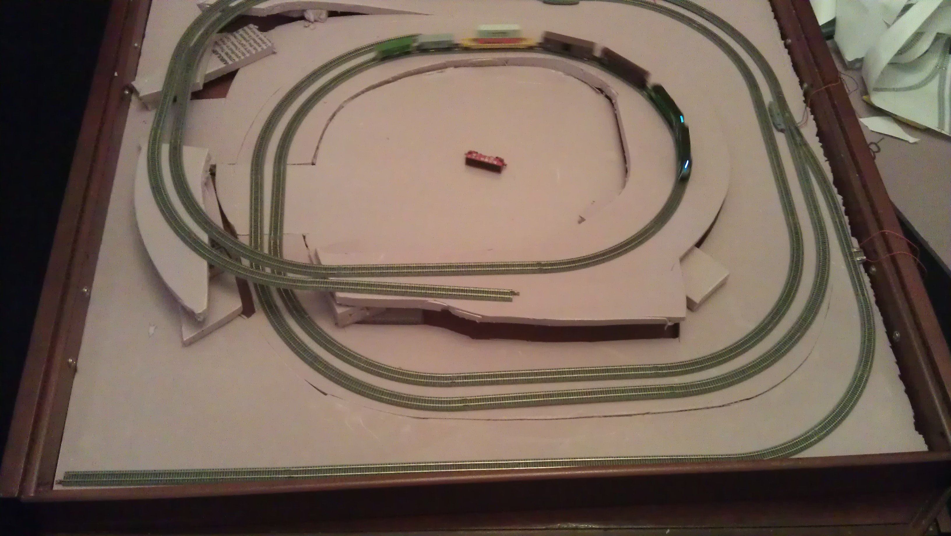

So I experimented with what seemed like hundreds of layout options using the Any Rail 5 program. Finally after trying to make a limited selection of MTL track pieces fit in such a confined space, I came up with a plan. A basic over an under with a double track main, plenty of sidings and a small yard should give me plenty to work with. I printed out my track plan at full scale on my plotter and laminated that to a 31 x 35 sheet of 1/2" insulating foam sheet. Using a box knife, I cut around the track where the grade will rise and fall. I'm, leaving plenty of room on the sides as I can always carve it away when things are secured. The separated sections will be gently raised to reach a 1-1/2" clearance point for the track to clear a double stack car (and then some). I laid the track out to test the design. Yeah, it works. Now to run the wiring and other basics.

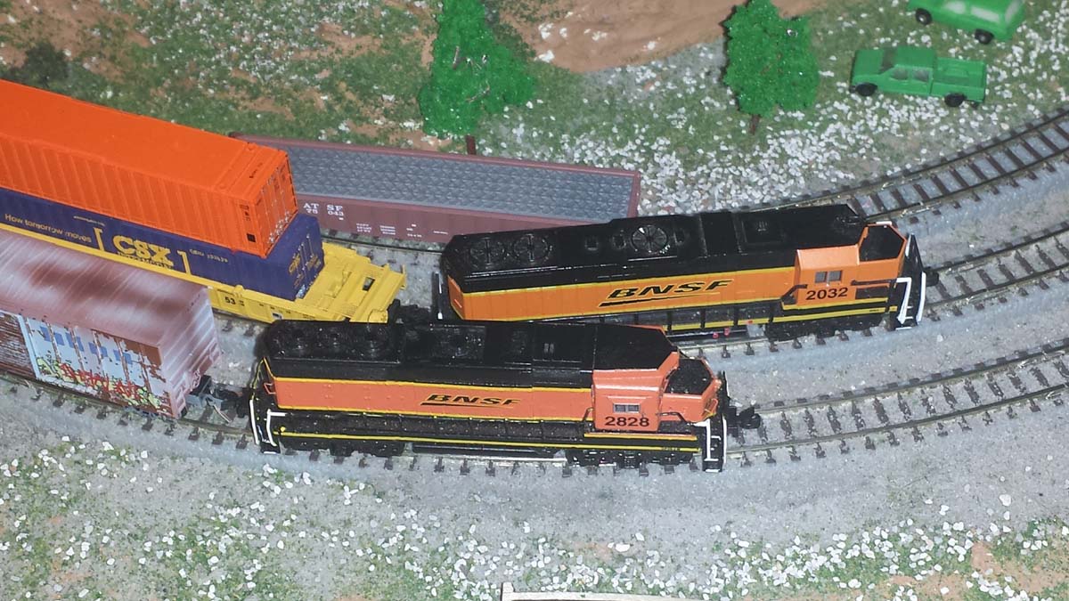

Some views of my AZL Geeps on the layout.
