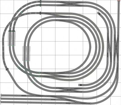

The revised trackplan:

PostPosted: Fri Apr 03, 2020 11:55 pm
Almost ready for prime time:
File comment: New Plan
I modified the plan to include a third double crossover at the yard entrance.

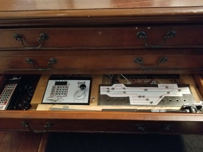

One side of the bottom drawer houses the controls:
File comment: Added temp overlay to panel
Don't worry; we will dress it up later. I still need to sync the turnouts with the switches. Some have polarity reversed.

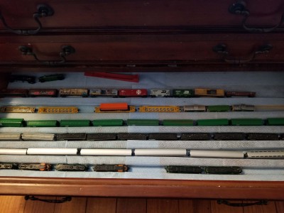

The other is for rolling stock storage. I need to order some felt, but these hand towels will work for now.
File comment: Added padded storage for engines and rolling stock
